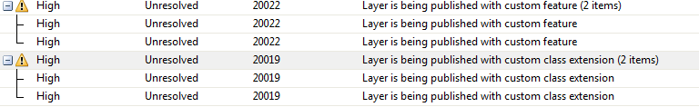

When publishing a map service with ArcFM data to ArcGIS Server, the following error messages are returned:
Error:
20019: Layer is being published with custom class extension
Error:
20022: Layer is being published with custom feature
Screenshot of the errors when publishing the map service.
