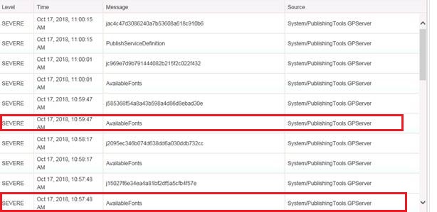

Attempts to publish services failed with an error, "Packaging succeeded, but publishing failed", and the server log recorded the following issue, SEVERE: "AvailableFonts". The message is associated along with the System/PublishingTools.GPServer message. The following image is the sample of the log message.
The issue indicates the AvailableFonts HTML and XML files that PublishingTools method is attempting to reference are missing from the PublishingTools folder in the working ArcGIS Server machine.
