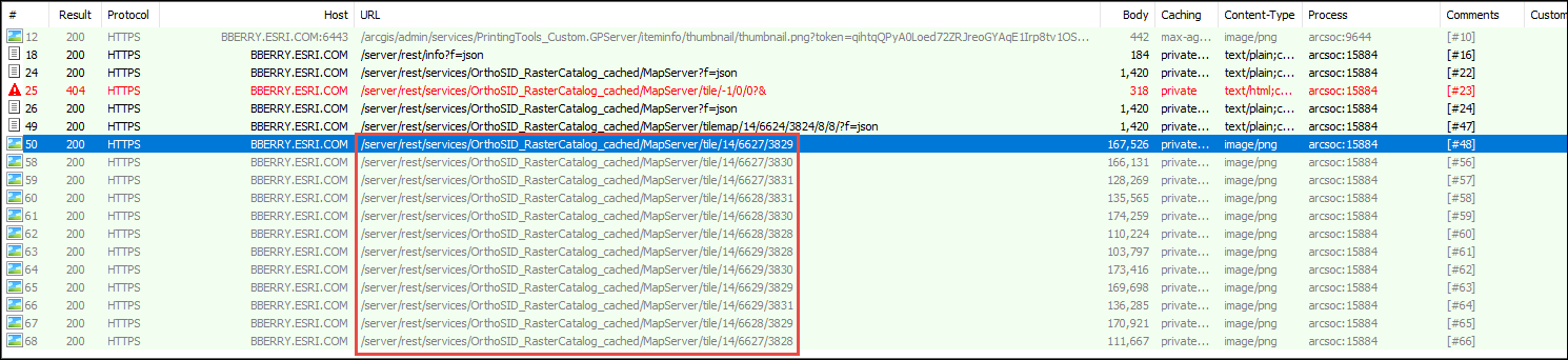

The following image shows the tiles are fetched and the print output generated successfully after disabling the dynamic layers.
The tiles are fetched if the dynamic layers are disabled
