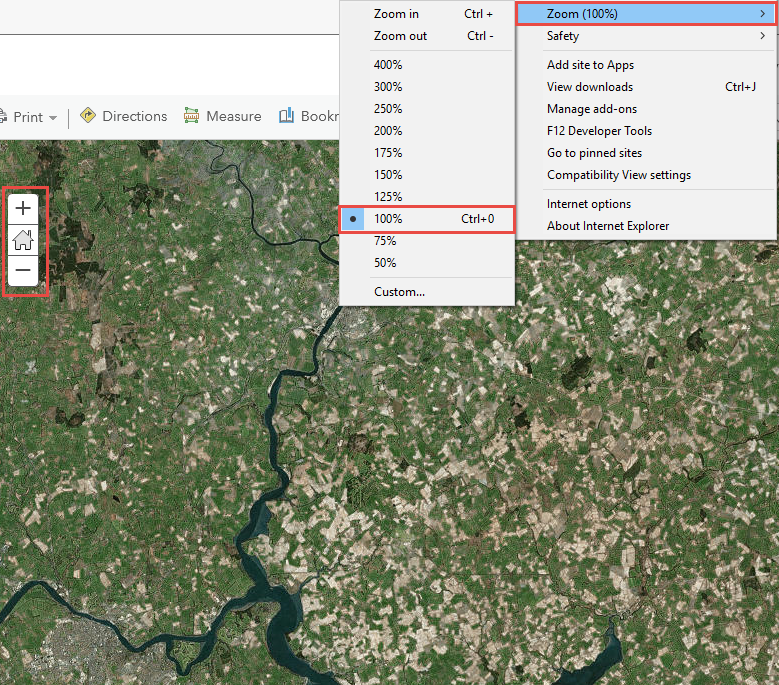

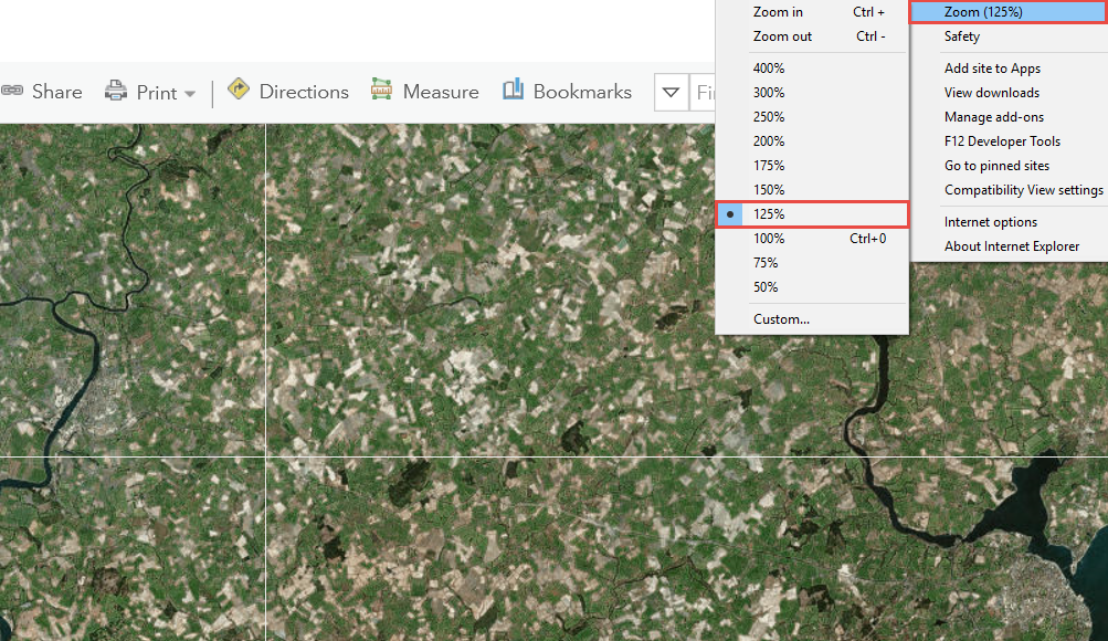

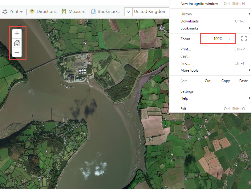

In ArcGIS Online, when zooming in and out of a basemap with the zoom level set to above or below 100%, white gridlines on the basemap are displayed. This issue occurs when Google Chrome or Internet Explorer is used as the browser to view the basemaps. The images below show the Imagery basemap in ArcGIS Online when the zoom level is set to 125% (top image) and 75% (bottom image) in Internet Explorer and Google Chrome.
This is a known limitation of the two browsers. White gridlines are displayed when the zoom level is adjusted to above or below the default 100% using the browser's zoom option. Similar gridlines appear when zooming in and out using the basemap's zoom option with the browser's zoom level set to above or below 100%.
When using Google Chrome or Internet Explorer to view basemaps in ArcGIS Online, use the basemap's zoom in or zoom out option with the zoom level of the browser set to the default 100%.
