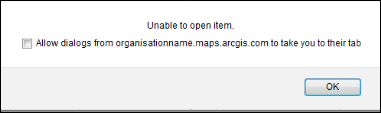

An organization can style their own ArcGIS Online home page by configuring the background image, banner, and featured content. In the featured content, the administrator can select a group to be featured on the home page up to 32 items to display. If a web app that is configured with the Maps and Apps Gallery template is shared to a group on an organization's home page in ArcGIS Online, the app fails to open with the following error message:
Error:
Unable to open item.
Error message
