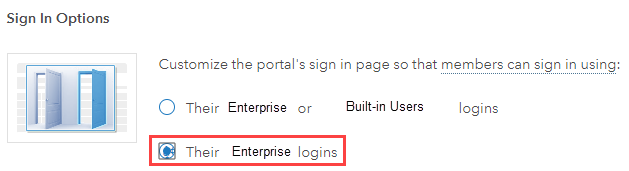

The Sign In Options of the enterprise login is set to 'Their Enterprise Login' only, as shown in the image below.
The image of the Sign In Options interface.

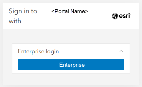

This option disables built-in user account logins and allows only enterprise logins.
The image of the login page interface.

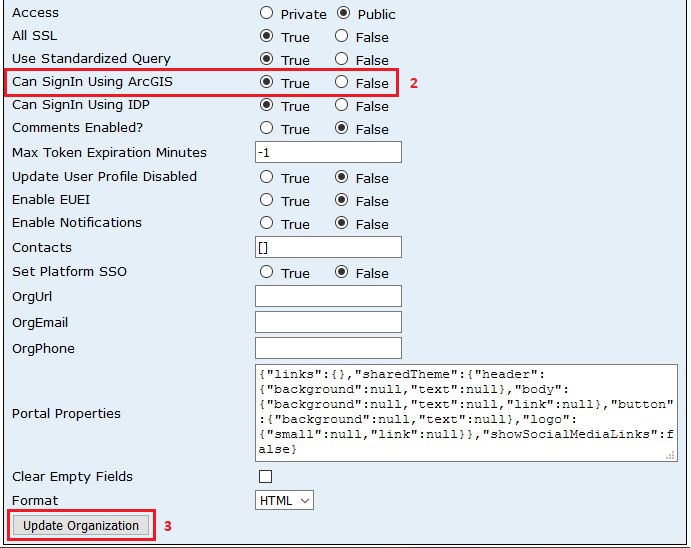

Reset the settings through ArcGIS Portal Directory.
  1. Sign in to ArcGIS Portal Directory through the following URL:
https://<portal.domain.com>:7443/arcgis/sharing/rest/portals/self/update
  1. Click on the Org ID : 0123456789ABCDEF
  2. Scroll to the bottom, and click Update under Supported Operations.
  3. Scroll to the Can SignIn Using ArcGIS radio button and select True.
  4. Click Update Organization. The steps enable user account logins.
The image of the update settings page in ArcGIS Portal Directory
