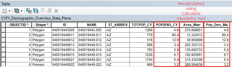

Field Calculator dialog box
Identical Population data density
