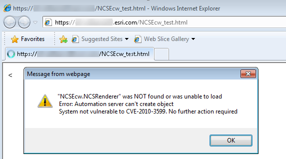

This can be verified independently. To do so, use the HTML in the appendix of the referenced document to check machines with ArcGIS Desktop and ArcGIS Engine. For example, a test on a machine running ArcGIS 10.2.2 returns the following message:
"NCSEcw.NCSRenderer" was NOT found or was unable to load
Error: Automation server can't create object
System not vulnerable to CVE-2010-3599. No further action required
User-added image
