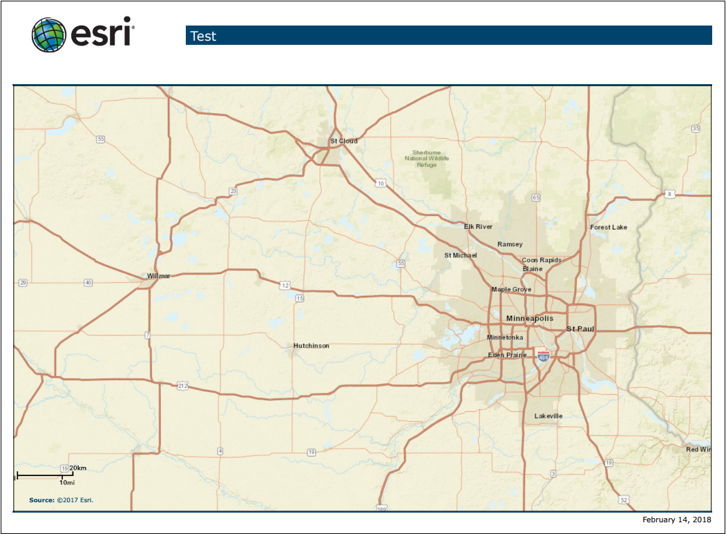

Exporting the map outputs a file displaying the map within the set default extent. The image below is an example of a PDF file exported from the map within the extent set as in the above image.
