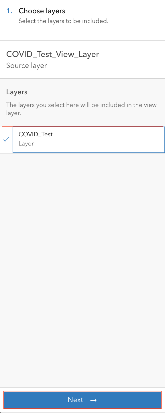

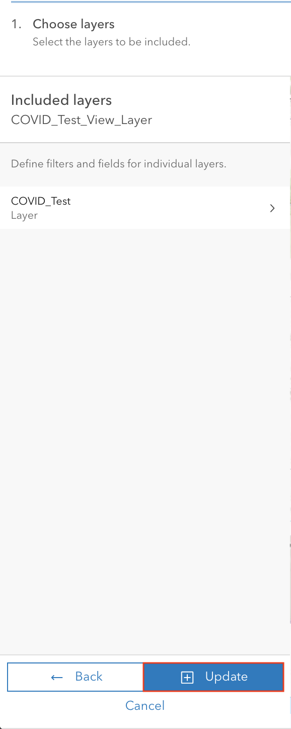

- In the Choose layers section, under Layers, ensure the view layer is selected. Click Next.

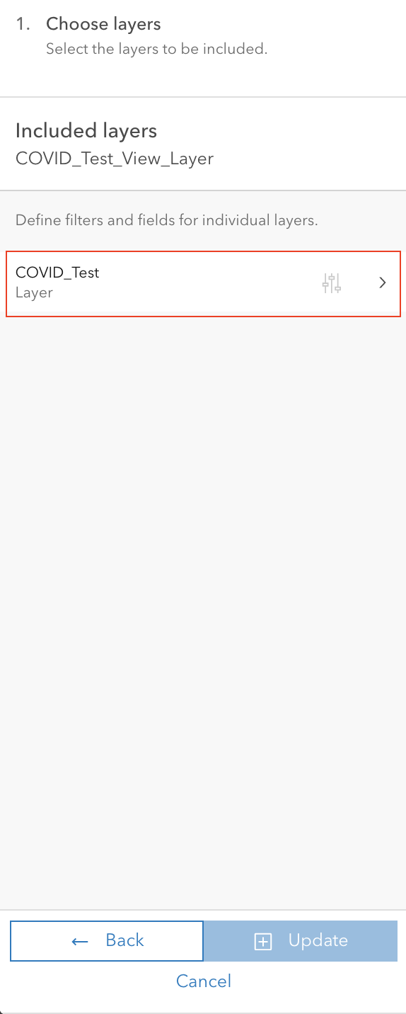

- Under Included layers, in the Define filters and fields for individual layers section, click the view layer.

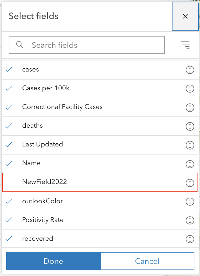

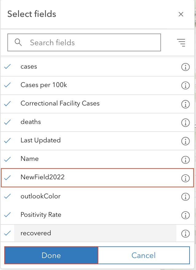

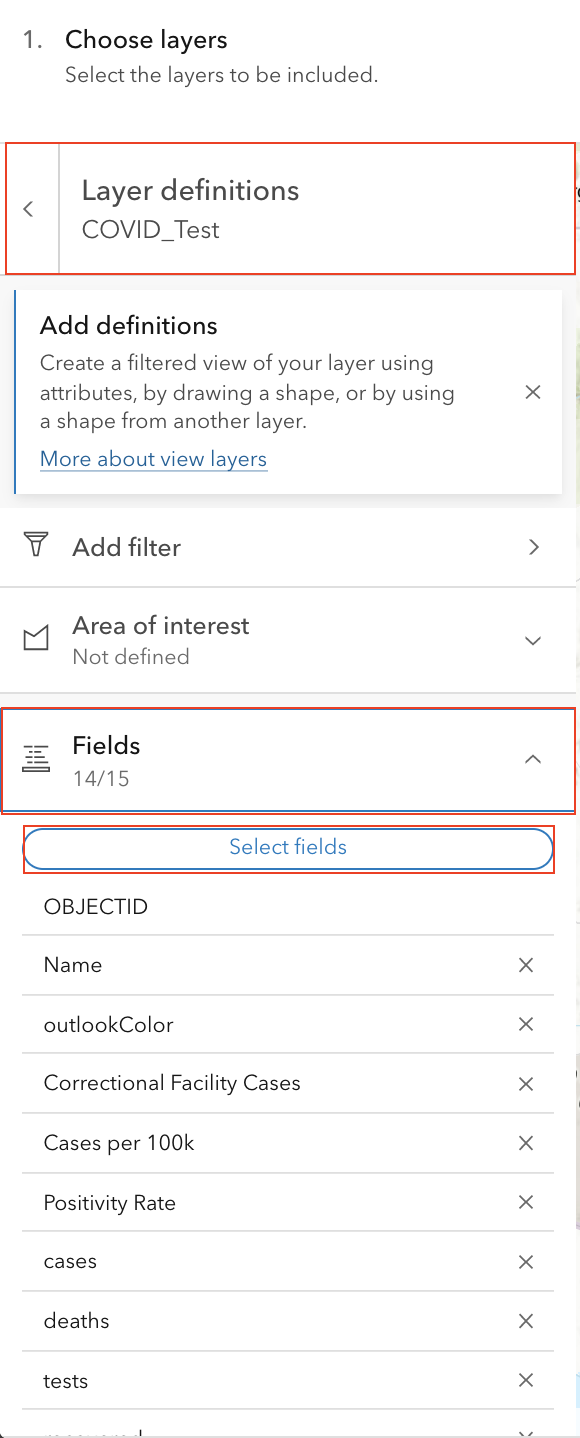

- In the Layer definitions pane, click the Fields tab > Select fields. The Select fields window opens.
- In the Select fields window, select the newly added field in the hosted feature service. In this example, the new field is NewField2022. Click Done.

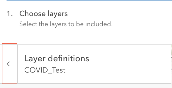

- Click the back button in the Layer definitions section.
- In the Included layers pane, click Update.
