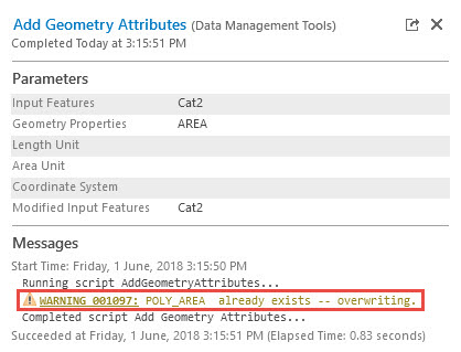

In ArcGIS Pro, running the Add Geometry Attributes tool on a polygon feature class or shapefile to determine the polygon area adds a new field in the attribute table and returns the following warning message:
WARNING 001097: POLY_AREA already exists -- overwriting.
Warning Image
