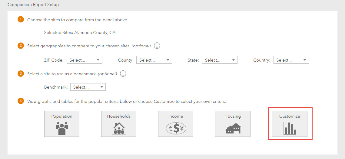

  2. Click the Comparison Reports tab or the Comparison Reports icon.
Image of the Comparison Reports tab and icon

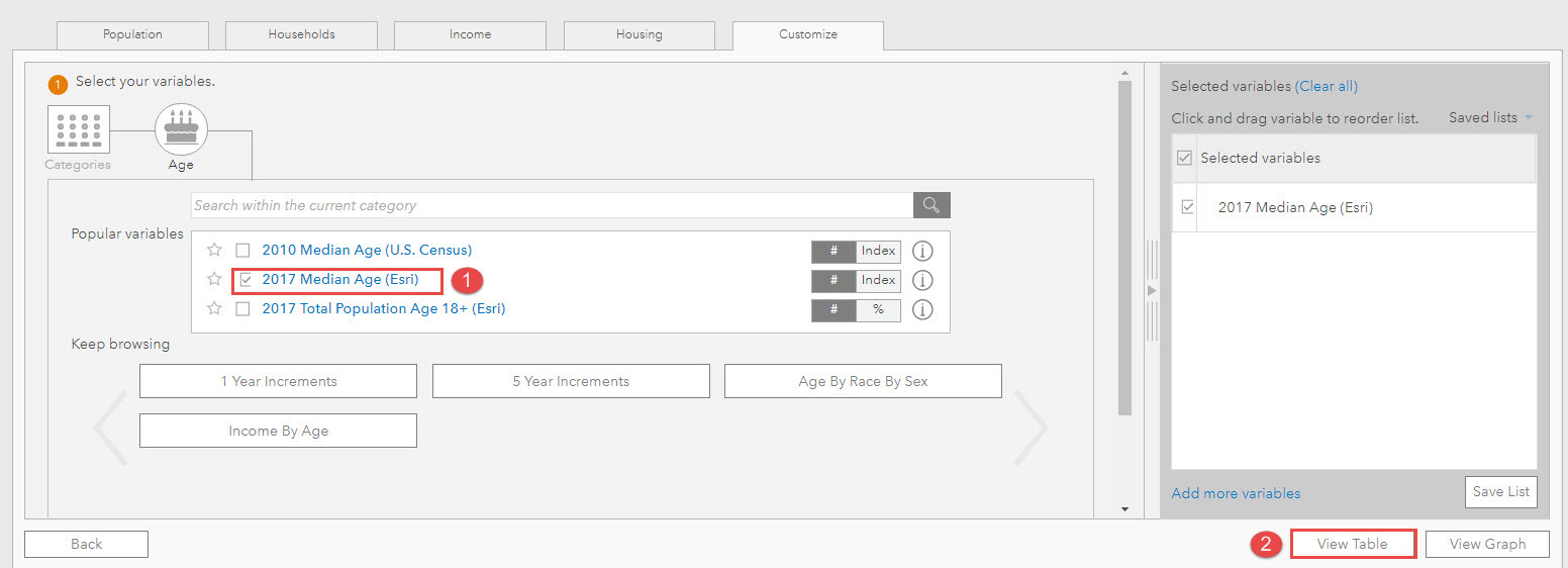

  1. On the Comparison Reports tab, create a new report or select the required report accordingly, and click Add variables.
Image of the Add Variables option

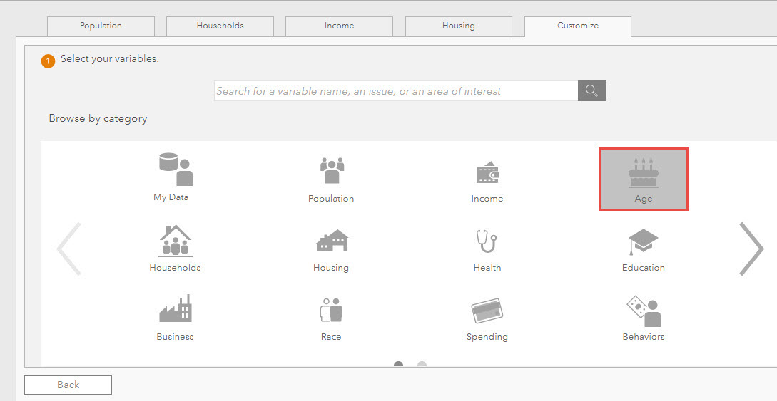

  1. In the Add Variables section, click Age.
Age icon

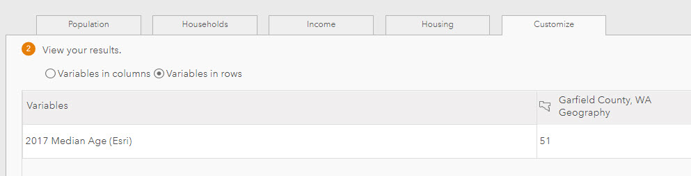

  1. In the Add variables section, check the 2020 Median Age (Esri) text box, and click Apply to view the median age of the population.
The 2020 Median Age (ESRI)
The image below shows the 2020 Median Age (Esri) displayed in ArcGIS Business Analyst Web App.
Image showing the 2020 Median Age (Esri)
