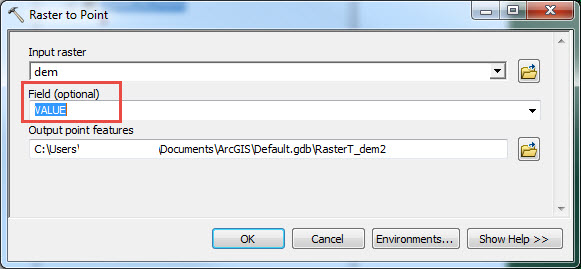

- Run the Raster to Point (Conversion) tool on the elevation raster and define the following parameters:
- For Input raster, select the desired raster to convert.
- For Field, select VALUE.
- For Output point features, select the output feature class to store the points.
Note:
The output of the VALUE field from each cell is an attribute of each corresponding point in the GRID_CODE field.
![Image of the Raster to Point tool dialog](https://webapps-cdn.esri.com/CDN/support-site/technical-articles-images/000016918/00N39000003LL2C-0EM39000000W20l.png)
