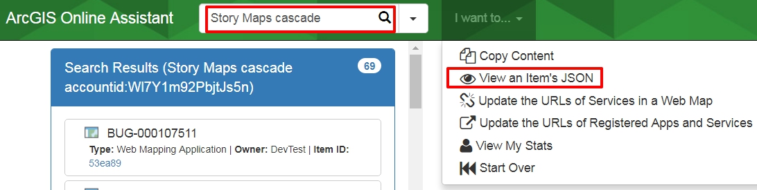

  1. Log in to ArcGIS Online Assistant.
  2. Search for the application in the Search tab, and choose the View an Item's JSON option in the I want to drop-down.

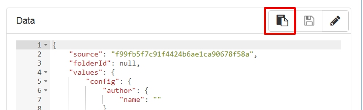

  1. Select the application, and copy the Data portion of the Story Map Cascade app's JSON. Ensure that the Item Detail section is not copied.
User-added image

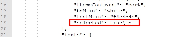

  1. Paste the script in a text editor such as Notepad++.
  2. Search for unicode characters such as line separators, in the lines identified in Step 4, and remove the characters from the text.
User-added image

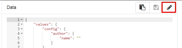

  1. Click the Edit JSON button of the Story Map Cascade app in ArcGIS Online Assistant.
User-added image

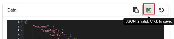

  1. Paste the updated version of the script, which has the unicode characters removed, and click the Save button.
User-added image
