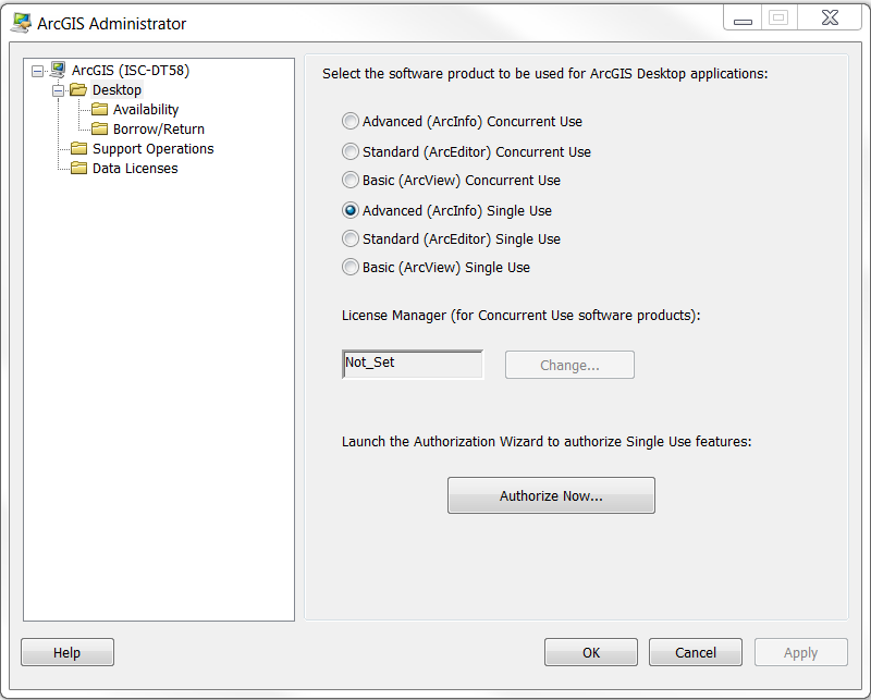

Ensure that the ArcGIS Desktop product level is set to a Standard or Advanced license. If the license level is set to a Basic license, follow the instructions below to change the product level.
  1. Close all ArcGIS Desktop applications.
  2. Navigate to Start All Programs > ArcGIS, and click ArcGIS Administrator.
  3. On the left pane of the ArcGIS Administrator utility, click the Desktop folder.
  4. On the right pane of the ArcGIS Administrator utility, select the desired product level, and click OK.
An image of selecting the software product in ArcGIS Administrator.
The image below shows the options are available for the database connection after changing the ArcGIS Desktop product level.
