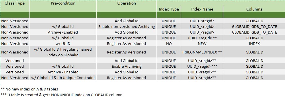

The behavior is summarized in the table below:
Class TypePre-conditionOperationIndex TypeIndex NamesColumns
Non-versioned Add Global IDUNIQUEUUID_<regid>GLOBALID
Non-versionedw/Global IDEnable non-versioned archivingUNIQUEUUID_<regid>GLOBALID, GBD_TO_DATE
Non-versionedArchive -EnabledAdd Global IDUNIQUEUUID_<regid>GLOBALID, GBD_TO_DATE
Non-versionedw/Global IDRegister as VersionedUNIQUEUUID_<regid>**GLOBALID
Non-versionedw/UUIDRegister as VersionedNONEWINDEX
Non-versionedw/Global ID and irregularly-named index on Global IDRegister as VersionedUNIQUEIRREGNAMEDINDEX**GLOBALID
Versioned Add Global IDUNIQUEUUID_<regid>**GLOBALID
Versionedw/Global IDEnable ArchivingUNIQUEUUID_<regid>***GLOBALID
VersionedArchive -EnabledAdd Global IDUNIQUEUUID_<regid>**GLOBALID
Non-versionedw/Global ID and db unique constraintRegister as VersionedUNIQUEUUID_<regid>**GLOBALID
** No new index on Adds and Deletes tables
*** H table is created and gets NONUNIQUE index on GLOBALID column
image of preceding table
