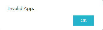

In some instances, users are unable to upload an application to Web AppBuilder for ArcGIS by choosing the Import from my computer option, and the following error message is returned.

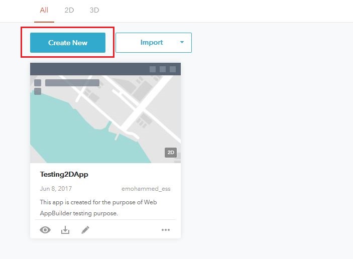

- Create a new application by clicking Create New, and select the desired type of application.
- Provide the necessary name and description for the application.

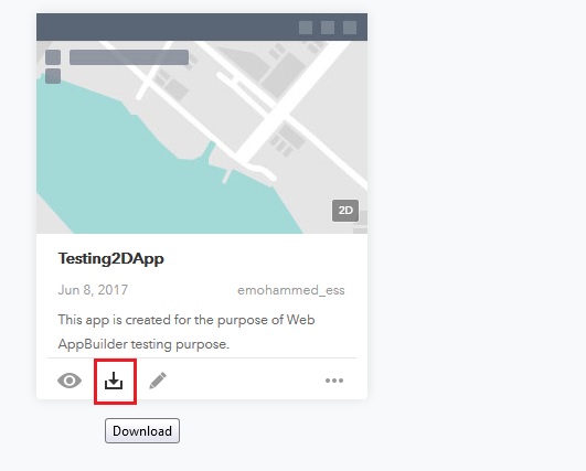

- Download the newly created application on the home page of Web AppBuilder for ArcGIS.
- Perform the necessary edits and re-upload the application to Web AppBuilder for ArcGIS. This maintains the folder architecture.
- Follow steps 1 and 2 in Scenario 1.
- Open the newly created application, and note the ID of the application at the end of the browser address bar. The following image shows an example of how the application link appears. In the example, the ID for the newly created app is 2.
- Download the newly created application.
