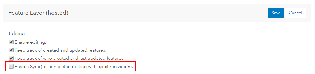

Disable the feature service synchronization to clear the tracking table, and reduce the size of the feature service. To do this, go to the item details page of the feature service, click the Settings tab, scroll to the Feature Layer (hosted) section, and uncheck the Enable Sync option. Click Save to save the edited settings.
An image of the Feature Layer (hosted) settings.
