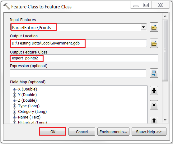

  • Run the Feature Class to Feature Class tool
    1. In ArcMap, open the Feature Class to Feature Class tool.
    2. For the input features, select the feature class that participates in the parcel fabric.
    3. Specify the output feature class location and name.
    4. Click OK. The feature class is exported as a stand-alone feature class.
An image of the Feature Class to Feature Class tool dialog box.

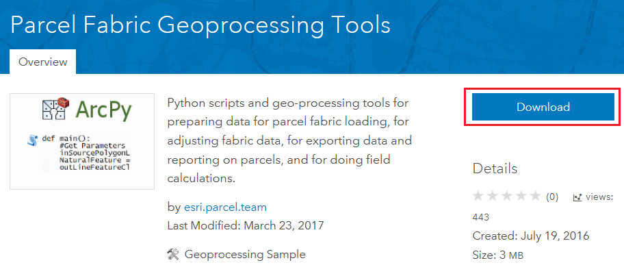

An image of the Parcel Fabric Geoprocessing Tools download page.
  1. Locate and open the downloaded ParcelFabricDataMigrationAndAnalysis.zip file.
  2. Extract the files.
  3. Double-click the INSTALL To My Toolboxes GP.bat file to install.

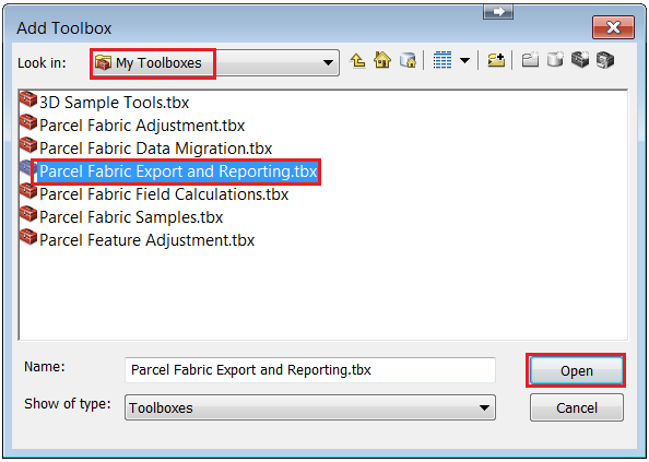

An image of adding a toolbox.
  1. In the Add Toolbox dialog, click Toolboxes > My Toolboxes > Parcel Fabric Export and Reporting.tbx, and click Open.
An image of the Add Toolbox dialog.

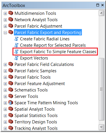

  1. In ArcToolbox, click Parcel Fabric Export and Reporting > Export Fabric To Simple Feature Classes to open the tool dialog box.
An image showing the Export Fabric To Simple Feature Classes tool in the ArcToolbox.

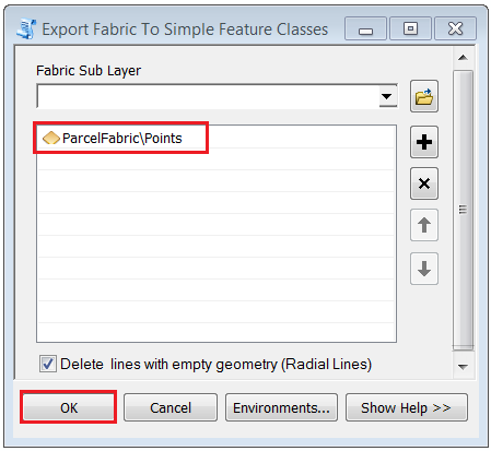

  1. Set the parcel feature class as Fabric Sub Layer > OK.
An image of the Export Fabric To Simple Feature Classes tool dialog.

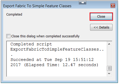

  1. Click Close. The resulting output data is stored in the default geodatabase in a feature dataset as ExportedFabricClasses with the name of the output feature class similar to the original layer.
An image of the completed dialog.
