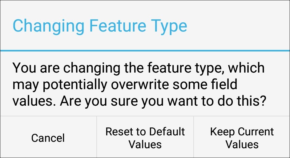

PROBLEM
When attempting to edit the attributes of features in a layer on Collector for ArcGIS, a prompt message is returned with the message, 'You are changing the feature type, which may potentially overwrite some field values. Are you sure you want to do this?'
The message is displayed if the field of the edited attributes is assigned to a domain and the layer symbology is set based on the field. For more information, refer to BUG-000088987.
