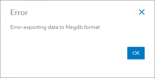

Republishing a feature class to ArcGIS Online, including the GDB_ServiceItems table, and exporting the republished feature service as a file geodatabase (FGDB, or filegdb) returns the following error:
Error: Error exporting data to filegdb format

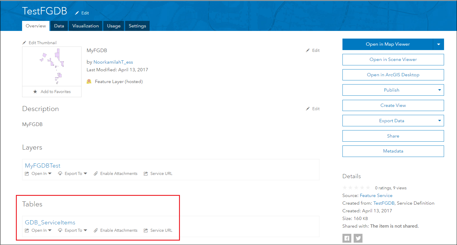

This is a known issue. When downloading a FGDB from ArcGIS Online, a table named GDB_ServiceItems is included in the downloaded FGDB as the database is created within runtime. When the feature class in the FGDB is brought to ArcMap or ArcGIS Pro, the GDB_ServiceItems table is included in the dataset. The error occurs due to the duplicate naming convention for the GDB_ServiceItems table, as the table already exists in the republished feature service.
The GDB_ServiceItems table is listed in the Tables section on the item details page of the republished feature service.
