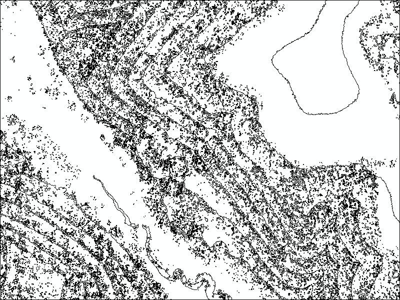

Contours created from full-resolution Lidar tend to be jagged with many twists and turns and isolated closed rings due to high frequency noise. For more information about noise from Lidar and how to get less jagged contours, refer to the following documentation: Minimizing noise from lidar for contouring and slope analysis.
