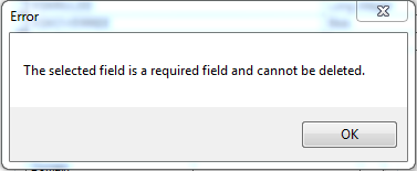

Error: ERROR 001334: Cannot delete required field <field>
Error Message
In some instances, when attempting to delete a field from an attribute table, the Delete Field option is disabled. Attempts to delete the field using the Delete Field tool return the following error message:
Cause
This error occurs because the Field IsRequired (optional) option is checked when creating the field using the Add Field tool. Required fields are permanent by design and cannot be deleted.
