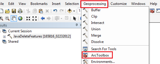

    1. On the ArcMap main menu, click the Geoprocessing menu > ArcToolbox.
The Geoprocessing menu in ArcMap main menu.

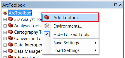

  1. Right-click the ArcToolbox shortcut menu > Add Toolbox.
Adding a toolbox in ArcToolbox.

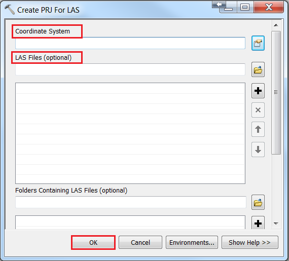

  1. Set the coordinate system and the .las file. The tool allows for the selected coordinate system to be applied to multiple .las files, or even a whole folder of .las files at one time.
  2. Click OK to run the tool. A .prj file with the same name as the input .las file is created, allowing ArcMap to read and apply the correct projection.
The Create PRJ for LAS tool dialog box.
