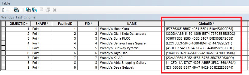

  4. In ArcMap, perform a join to append the attribute fields from the downloaded feature class to the original feature class. To do so, right-click the original feature class, and select Joins and Relates > Join. The join is based on the unique ID fields that exist in both tables. When this step completes, the GlobalID field created in ArcGIS Online is added to the original feature class.
The GlobalID added to the original feature class

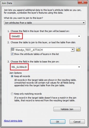

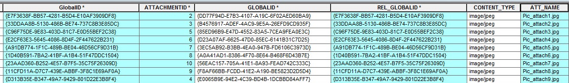

  1. Perform a second join to append the attribute fields from the downloaded attachment table to the joined table created in Step 4. This join is based on the GlobalID and REL_GLOBALID fields in the downloaded attachment table. When this step is completed, the attachment IDs and names from the Collector data is added to the original feature class.
The Join Data dialog box
The original feature class after the second join

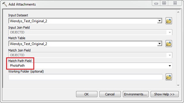

  2. Use the Add Attachments tool to add the attachments to the feature class. When this step completes, a new relationship class is created for the original feature class containing an attachment table with all the attachments.
The Add Attachments tool
