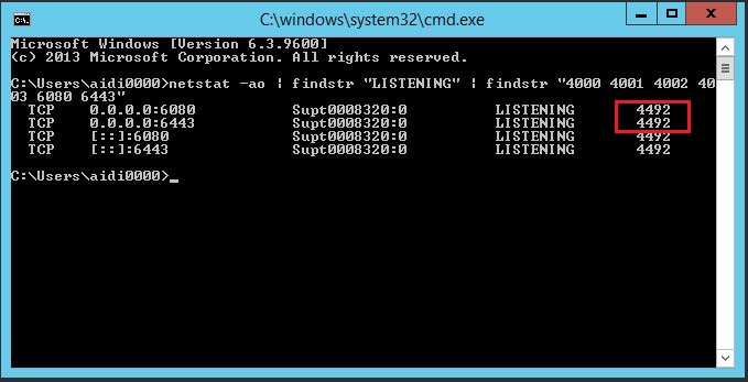

  2. Run the following command.
netstat -ao | findstr "LISTENING" | findstr "4000 4001 4002 4003 6080 6443"

Check the printed list. If the searched ports are not listed, the ports are available and nothing is listening to the port. However, if any of the ports is unavailable, it is listed as shown in the following image. The column on the far right shows the Process ID (PID) of the process currently using the port.
The image of a sample of listened ports.

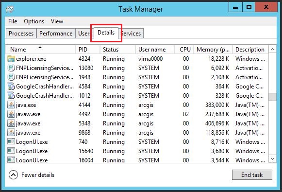

  2. Click the Details tab.
  The image of the Details tab on the Windows Task Manager

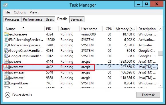

If the PID matches the javaw.exe process with the username arcgis, this means the port is currently connected to ArcGIS Server. Otherwise, the process currently connected to the port is identified. The following images are examples showing ports and PIDs connected to ArcGIS Server.
The image of Windows Command Prompt with listened ports
The image of the Windows Task Manager
