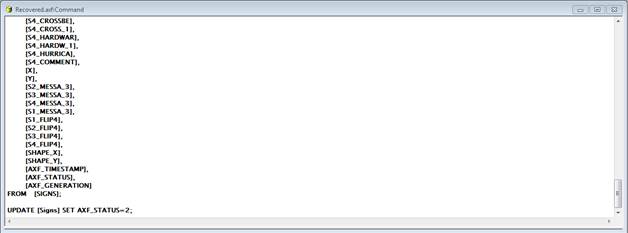

  4. Run an UPDATE query against the data that alters the value in the AXF_STATUS field. All checked in records must have a value of 16777216, which stands for Processed/Checked In data. Use 2 for records that have been modified and 1 for new records. See below for what each value represents;
  5. The following screenshot shows where to execute the SQL command.
  6. Type a SQL query with the following syntax in the space provided:
    UPDATE table_name SET AXF_STATUS=value;
    Where table_name is the name of the feature class in upper case (e.g. SIGNS) and the value is either 1 or 2 depending on whether new data is being created or existing data is being updated in the geodatabase.
  1. Run the query by clicking the red exclamation point in the toolbar, which is the Execute tool, and the SQL command is executed.
    A message with the number of records updated is returned. Using an incorrect syntax results in an error. To view the changes, close the .axf file and reopen in ArcStudio. Click Show Data or test by running the following SQL query:
