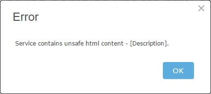

Creating a New Hosted Feature Layer from My Content using the option for From URL fails and results in the following error. This error is typically seen when entering the URL of a feature service that has been published from ArcGIS Pro.
Error:
Service contains unsafe html content - [Description].
An image of the error message as it appears in ArcGIS Online.
