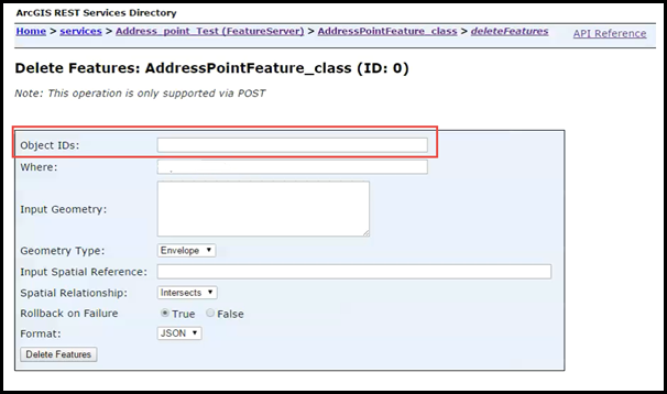

However, there is an alternative of doing so from the REST URL. Features in a service can be edited using supported operations from the ArcGIS REST API, which accesses the underlying framework of ArcGIS Online. These supported editing operations include Create, Update, and Delete functions. Users can do batch deletion using Delete Features by the Object IDs.
To delete multiple features from a hosted feature service using the ArcGIS REST API, follow the steps below:
