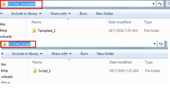

This issue occurs when there are multiple folders registered as data source locations. For instance, a Python script and an ArcMap layout template file are located in separate folders, and registered individually as data sources.
Image of seperate root folders
