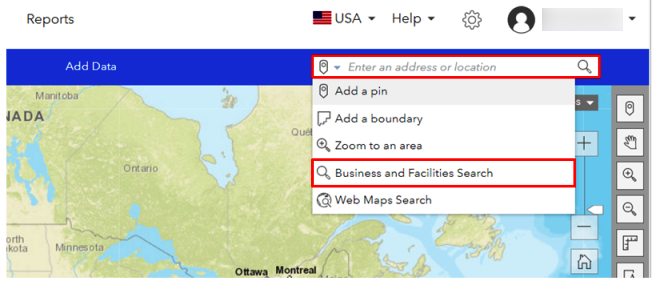

  1. On the Maps tab, click the Search tool drop-down arrow, and select Business and Facilities Search.
Image showing the Search Tool drop-down menu

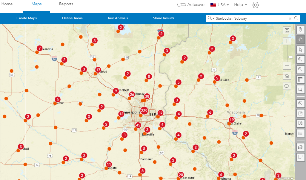

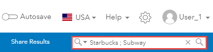

  1. Type the business or facility name(s) separated by a semicolon, and press Enter.
Image showing the use of semicolon
The business or facility locations are displayed on the map.
Image showing the locations are displayed on the map
