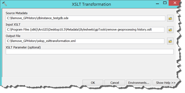

  2. Run the XSLT Transformation geoprocessing tool to generate an .xml from the database with the geoprocessing history removed.
    • Source Metadata: The database connection
    • Input XSLT: The Esri tool located at:
C:\Program Files (x86)\ArcGIS\Desktop10.5\Metadata\Stylesheets\gpTools\remove geoprocessing history.xslt
  • Output File: Provide a location to save the output .xml file
The XSLT Transformation tool window with the appropriate parameters filled.

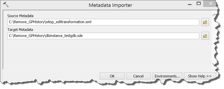

  1. Run the Metadata Importer geoprocessing tool to import the output .xml file into the enterprise geodatabase.
    • Source Metadata: The output .xml generated from Step 2
    • Target Metadata: The database connection
The Metadata Importer tool window with the appropriate parameters filled
