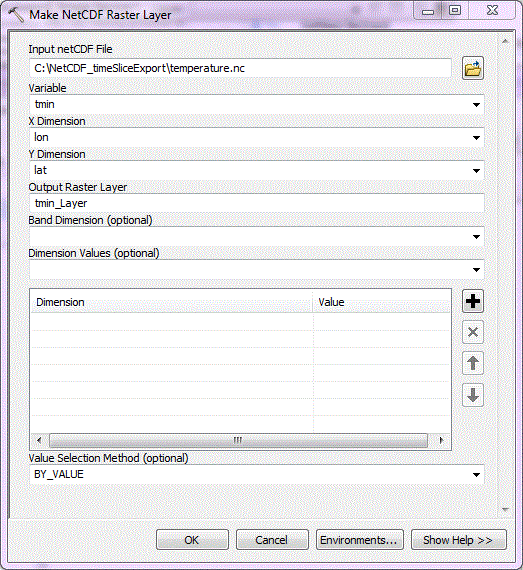

- Navigate to ArcToolbox > Multidimension Tools > Make NetCDF Raster Layer.
- Select a file for Input netCDF File, and set all the other parameters.

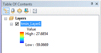

- Click OK. The tool creates a NetCDF raster layer and adds it to the table of contents.

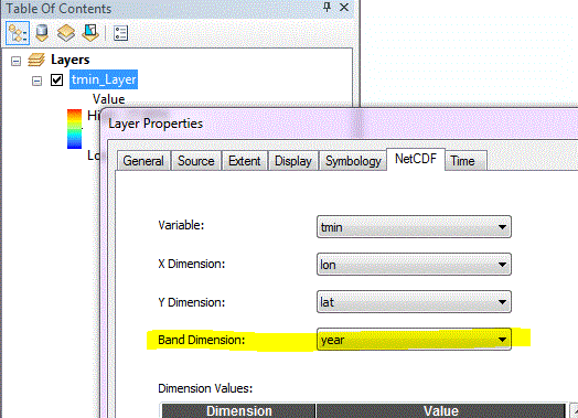

- Right-click the NetCDF layer, and navigate to Layer Properties > NetCDF. Select a Band Dimension if one has not already been selected.

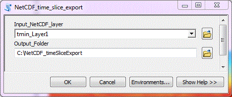

- Open the NetCDF_time_slice_export script tool.
- Select the Input_NetCDF_layer and an Output Folder. Click OK to run the tool.
The tool exports all the time slices (bands) from the NetCDF raster layer as TIFs. The following shows the Python code used for this script tool. This code can be modified to meet various needs.
