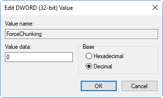

  3. Double-click ForceChunking to open the Edit DWORD Value dialog box.
  1. In the Edit DWORD Value dialog box, click Decimal and enter an integer in the Value data text box.
Note:
Network Analyst looks at this ForceChunking key value to determine whether it should apply chunking during a closest facility solve process. A value of 0 (zero) indicates that chunking should not be applied. Any non-zero value indicates chunking should be applied. The number 1 could be entered, for example, to turn chunking on.
