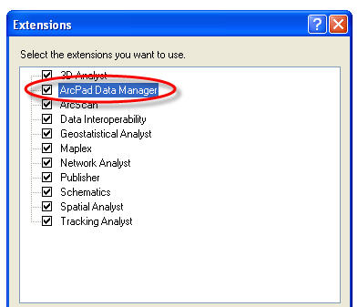

The ArcPad Data Manager extension and toolbar is available the next time ArcMap is opened yet must be activated prior to use. In ArcGIS Desktop 10.3x and later, navigate to Customize > Extensions and check the box next to ArcPad Data Manager to enable the ArcPad Data Manager extension.
Image of the ArcPad Data Manager checkbox checked in Extensions dialog.
