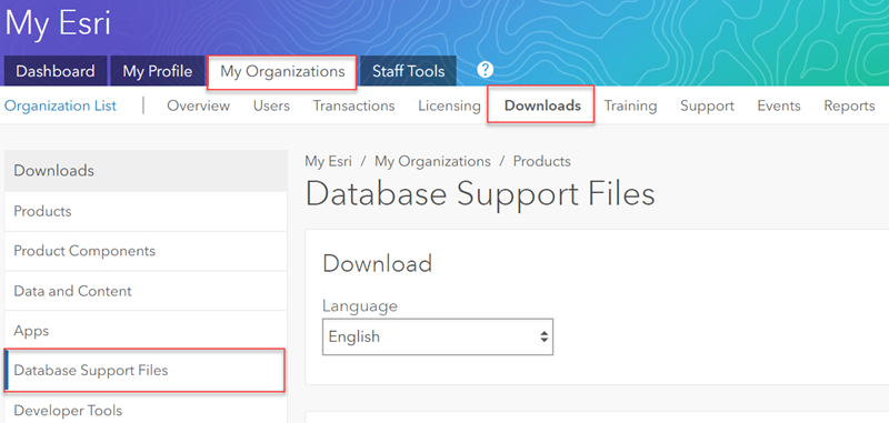

Microsoft ODBC Drivers for SQL Server and the SQL Server Native Client are available for download from Microsoft. Copies can also be found in My Esri. To download these copies:
  1. Log in to My Esri.
  2. Navigate to My Organizations > Downloads > Products.
The Product tab in My Esri
  1. Scroll to ArcGIS Enterprise, and click View Downloads.
  2. Scroll to Database Support Files, and click Download on the relevant Microsoft ODBC Driver version.
Download the latest ODBC driver under the Database Support Files section in My Esri.
