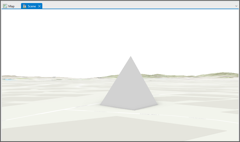

The image below shows the multipatch feature created in ArcGIS Pro.
A 3D pyramid in ArcGIS Pro

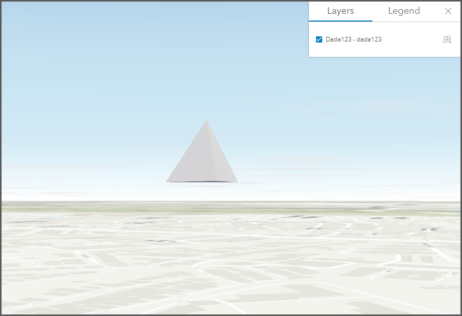

The image below shows the multipatch feature after exporting to ArcGIS Online.
A 3D pyramid floating above the ground in ArcGIS Online

When a multipatch feature is published from ArcGIS Pro to ArcGIS Online, the following warning message is returned:
Warning: Ellipsoidal vertical coordinate systems may draw incorrectly
This is an expected behavior when an unsupported Z coordinate system is used to create the feature. Subsequently, publishing the multipatch feature to ArcGIS Online with an unsupported Z coordinate system causes the feature to display incorrectly.

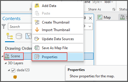

  1. In ArcGIS Pro, right-click the scene layer in the Contents pane and select Properties.
Properties is selected from the scene layer menu

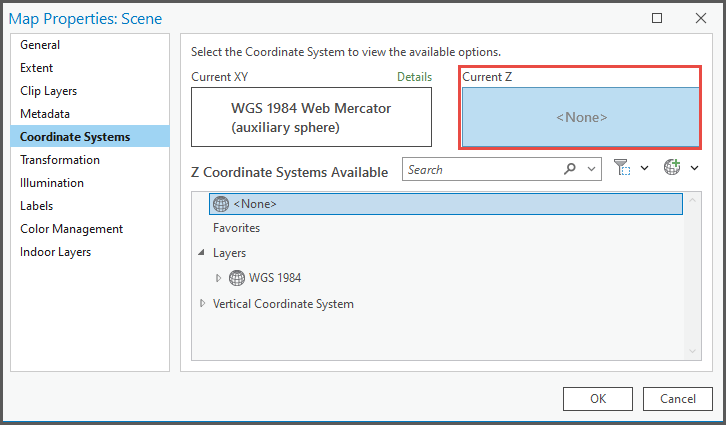

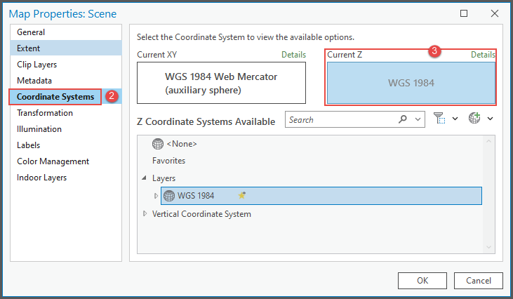

  1. In the Map Properties: <scene name> pane, click Coordinate Systems.
  2. Click Current Z.
Map Properties window with Current Z selected
  1. Under Z Coordinate Systems Available, change the coordinate system to <None> or to a supported coordinate system. There are two supported vertical coordinate systems: ellipsoidal and gravity-based system, for example, EGM2008 or EGM1996.
Current Z is set to None

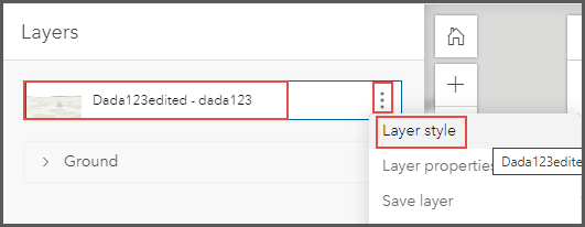

  1. In ArcGIS Online, under My Content, open the imported scene layer in Scene Viewer. In this example, the layer name 'dada123edited' is used.
  2. Under Layers, click the ellipsis icon on the layer and select Layer style.
Click the ellipsis icon

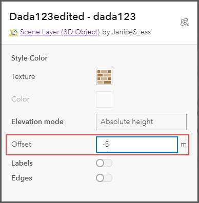

  1. In the <Layer name> pane, under Choose a drawing style, click Options.
Select drawing style
  1. For Offset, enter a positive or negative value in meters to offset the layer higher or lower. Click Done.
Select an appropriate offset
The image below shows the multipatch feature display correctly on the ground.
A 3D pyramid at ground level in ArcGIS Online
