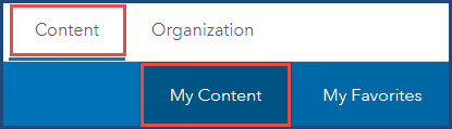

- Click Content > My Content.

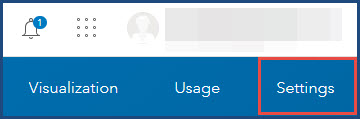

- On the item details page, click the Settings tab.
- Under Feature Layer (hosted), in the Editing section, uncheck the Enable Sync (require for offline use and collaboration). check box to disable sync.
- Click Save.
