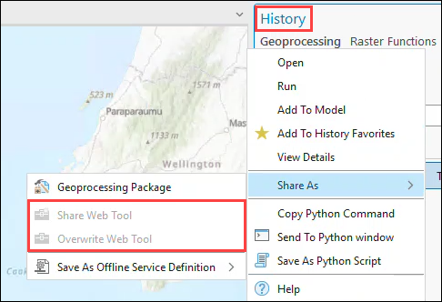

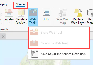

The Share Web Tool and Overwrite Web Tool functions are unavailable when accessed from the Share tab and the History pane.
The Share tab in ArcGIS Pro and the unavailable Share Web Tool and Overwrite Web Tool functions.
The History pane in ArcGIS Pro and the unavailable Share Web Tool and Overwrite Web Tool functions.

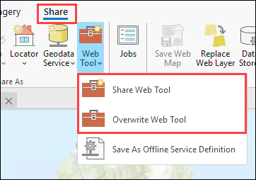

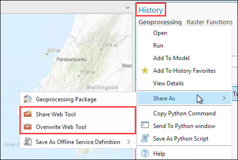

After logging in with a portal account in ArcGIS Pro, the Share Web Tool and Overwrite Web Tool functions are available when accessed from both the Share tab and the History pane.
The Share tab in ArcGIS Pro with the Share Web Tool and Overwrite Web Tool functions available.
The History pane in ArcGIS Pro with the Share Web Tool and Overwrite Web Tool functions available.
