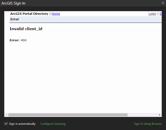

When starting Drone2Map 2022.1 or newer using a Named User License from an ArcGIS Enterprise portal, the following error may be returned:
"Invalid client_id Error: 400."
This error is common with authentication issues, however this is not always the case. This article discusses one of the potential causes and a fix for the issue.
