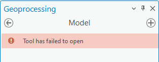

In ArcGIS Pro, geoprocessing workflows involving multiple tools can be automated using ModelBuilder and be saved as a model tool in a toolbox. These tools are run as any other geoprocessing tool from the Geoprocessing pane. In some instances, opening a model tool may cause ArcGIS Pro to crash or return the following error message in the Geoprocessing pane:
Error: Tool has failed to open
