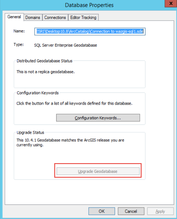

The following behavior has been observed when attempting to upgrade a SQL Server Enterprise Geodatabase using an ArcGIS client: Connecting to the geodatabase and navigating to the Database Properties the Upgrade Geodatabase button is disabled, as shown in the next image.

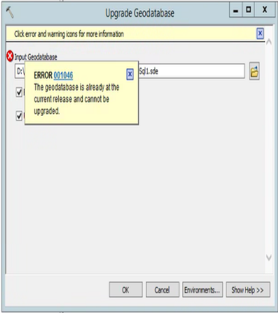

Running the Upgrade Geodatabase tool fails with the following error:
Error 001046 The geodatabase is already at the current release and connect be upgraded.

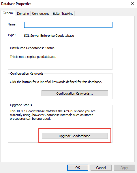

Upgrade the SQL Server instance to SQL Server 2019, which is supported with ArcGIS 10.9.x clients. If this resolves the issue, the option to Upgrade the Geodatabase becomes available, as shown in the next image of the Database Properties dialog box.

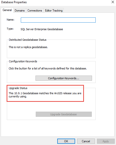

Upgrading the geodatabase to 10.9.1 should also be successful, as shown in the following image of the Database Properties.
