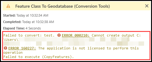

ArcGIS Pro allows exporting a feature class to a geodatabase using the Feature Class To Geodatabase tool. In certain cases, exporting a feature class to an enterprise geodatabase using the Feature Class To Geodatabase tool fails, and returns the following error messages:
Error: 000210: Cannot create output <output_directory>.
Error: 160227: The application is not licensed to perform this operation Failed to execute (CopyFeatures).
