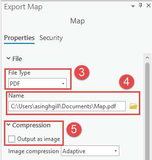

The ‘Output as image’ check-box was checked in the Export Map Properties pane before exporting the map as a PDF.

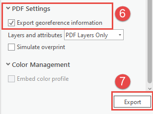

Ensure that the Output as image check-box is unchecked in the Export Map dialog box before exporting the map as a PDF.
Labels can now be searched using the Find box in the PDF reader as shown in the image below.
