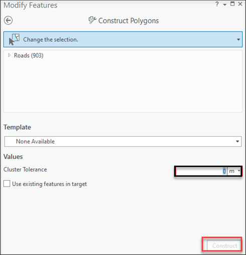

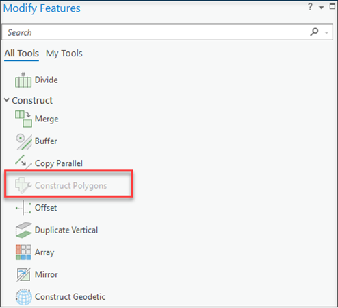

The Construct Polygons tool is used to create new polygons for each closed boundary formed by selected line and polygon features. There are instances where the Construct Polygons tool is disabled in the Modify Features pane or the Construct button is disabled in the Construct Polygons window, as shown in the images below.
The Modify Features pane with the Disabled Construct Polygons tool option.
The Construct Polygons tool window with the Disabled Construct box
