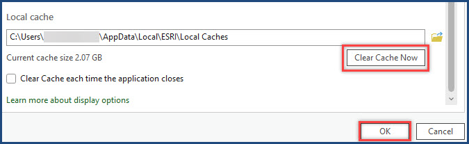

Clear the cache
Clearing the memory cache of a project or a layer helps to free up disk space. Follow the options provided below to clear the cache.
