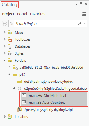

  4. In the Catalog window, navigate to the folder location of the recovered runtime geodatabase. Drag and drop the geodatabase files to add the layers to a new map view in ArcGIS Pro.
In the Catalog pane, two layers are dragged from the recovered geodatabase to the map view

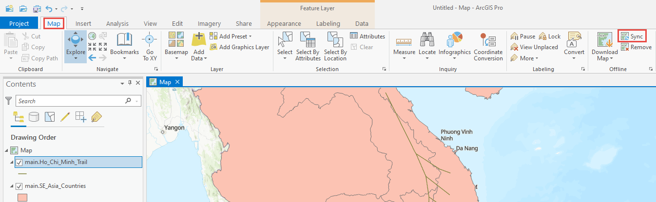

  1. On the ribbon, select the Map tab. In the Offline group, the Sync and Remove tools become active when a valid offline dataset is added to the map contents.
  2. Click Sync.
The location of the Sync icon in the Offline group of the Map tab
