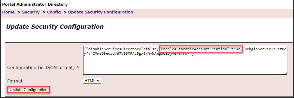

Set the enableAutomaticAccountCreation setting to ‘true’
  1. Log in to the Portaladmin API using an administrator account. For example:
https://portal.domain.com:7443/<web adaptor name>/portaladmin
  1. Select Security > Config > Update Security Configuration.
  2. Edit the enableAutomaticAccountCreation configuration to read: true.
  3. Click Update Configuration.
The Update Security Configuration page with the Set enableAutomaticAccountCreation configuration set to ‘true’.
