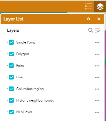

When creating an ArcGIS Web AppBuilder app using a web map with group layers, the group layers are flattened to individual layers in the Layer List widget.

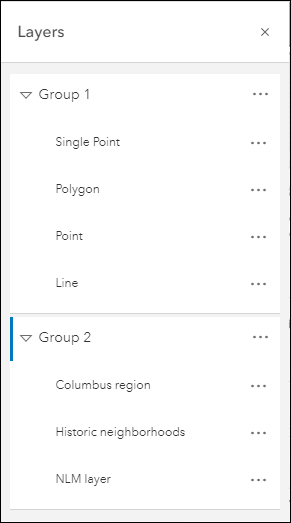

In the Map Viewer Layers pane
The image of Map Viewer supporting the visualization and configuration of group layers.
In the ArcGIS Web AppBuilder Layer List widget
The image of ArcGIS Web AppBuilder not supporting group layers.

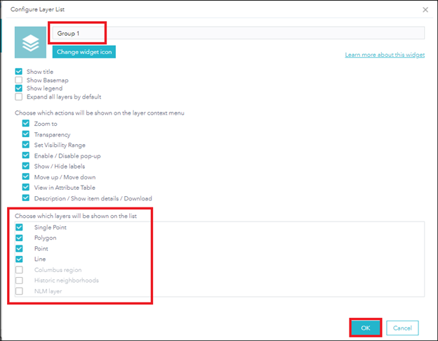

Create multiple Layer List widgets and configure them to display the group layers
In ArcGIS Web AppBuilder, add multiple Layer List widgets, and group them to display the group layers.
  1. In ArcGIS Web AppBuilder, on the Widget tab, click Set the widgets in this controller.
  2. On the Widget tab, click Click here to add widget > Layer List > OK.
  3. In the Configure Layer List window, set the following parameters:
    1. Name the widget according to the group layer’s name. In this example, the Layer List widget is Group 1.
    2. Under Choose which layers will be shown on the list, uncheck the non-related layers. In this example, the group layer named Group 1 comprises the layers titled Subway Stations, Public Bicycles, and Subway Lines.
    3. Click OK.
The Layer List widget providing a list of operational layers and their symbols, and allowing users to turn individual layers on and off.

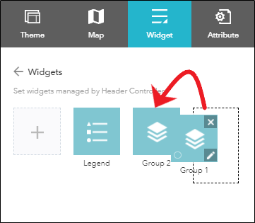

  2. On the Widget tab, in the Widgets pane, drag and drop all the Layer List widgets to create a widget group.
Drag and drop to group the Layer List widgets together.

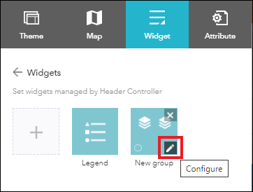

  1. On the Widget tab, hover over the widget group, and click Configure.
Configure the widget group to rename it.
  1. In the Configure window, specify a name for the widget group, and click OK. In this example, the group is named Layer List.

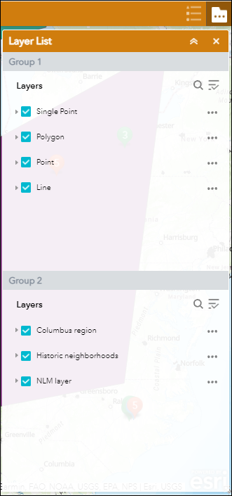

The image below shows the layers grouped accordingly in the ArcGIS Web AppBuilder Layer List widget.
The image of the group layers being displayed in different Layer List widgets accordingly in ArcGIS Web AppBuilder.

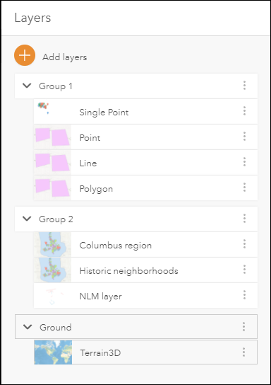

  1. In Scene Viewer, create a new scene, and add the desired layers to it.
  2. In the Layer Manager pane, browse to a layer, click More Options Click the More Options button to display the drop-down list., and select Add to new group.
  3. Rename the group, and drag the desired layers into the group.
The image of the group layers being created in the Scene Viewer Layers pane.

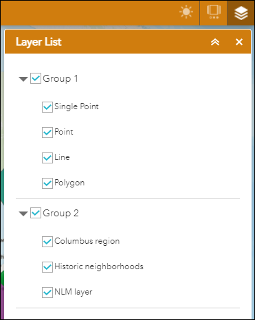

The image below shows the group layers displayed in the ArcGIS Web AppBuilder Layer List widget.
The image of the group layers being displayed in ArcGIS Web AppBuilder.
