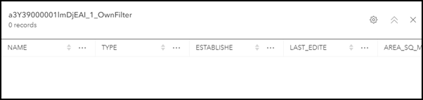

The image below shows the cells do not display when filtered using the ‘is blank’ expression.
Cells do not appear when filtered

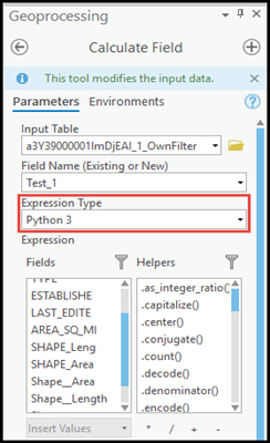

  1. In the Calculate Field pane, under Parameters, select the desired layer for Input Table and specify a name for Field Name.
Select desired layer and name

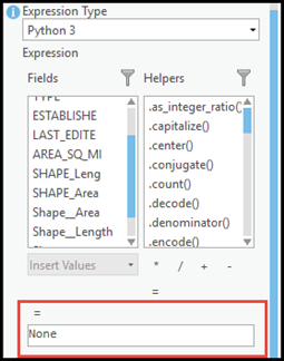

  1. For Expression Type, select Python 3.
  2. Under the = section, fill in None. Click Run.
Under = section, fill in None

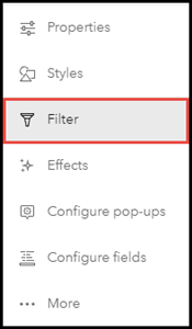

  1. Select Filter.
Select Filter
